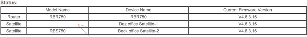

Thanks. It'll be a hassle due to an update but I'll give it a shot. I've just noticed on the admin website that one of my satalites doesn't have a model name when I check for updates on the advanced admin section. It was there before but I can't see how to add it back in. May that be causes an issue?

This is what I mean: 1st imagines shows how it is under "attahced devices" list. 2nd is how it shows in the firmware update section.
