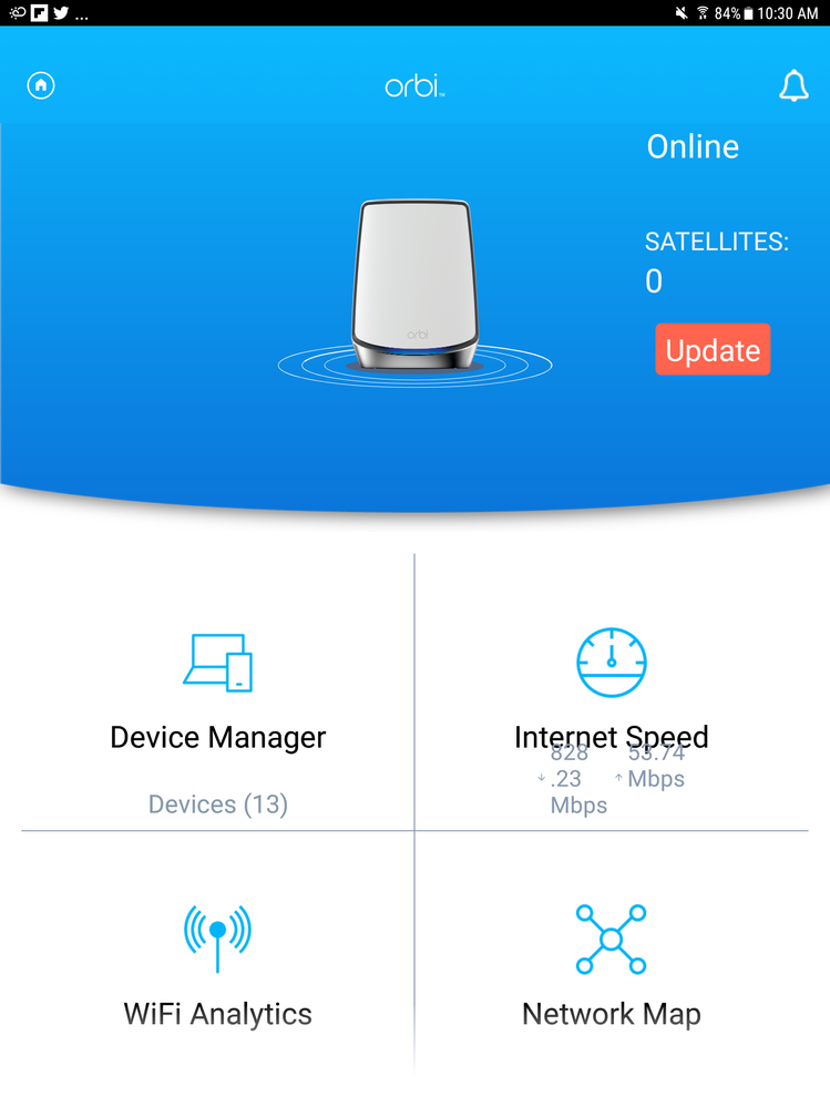

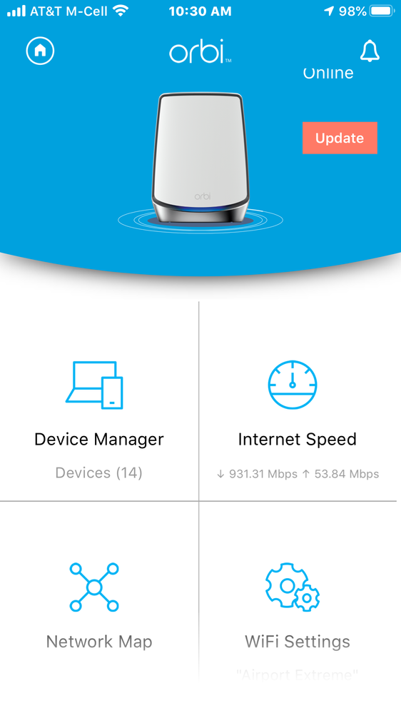

- FURRYe38Jun 02, 2020Guru - Experienced User
Ok, I just downgraded the RBS and RBR to v11.2. Rebooted everthing.
I can access the RBR in AP mode using the app on both apple and android:
Christian_R wrote:Hello Orbi AX Family,
Curious to know if you guys have had a chance to roll back a previous firmware version on the RBR850. If so, I'm interested in hearing the results.
