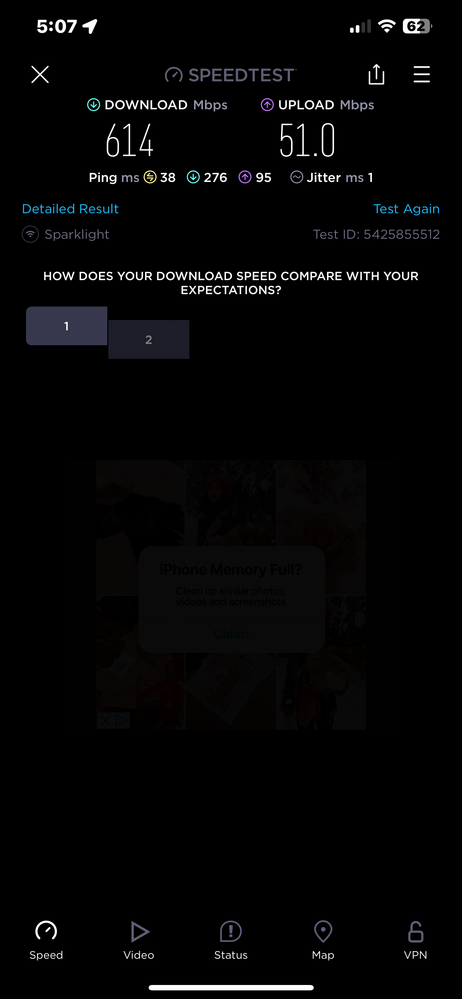

Here is my iphone results behind the RBS:

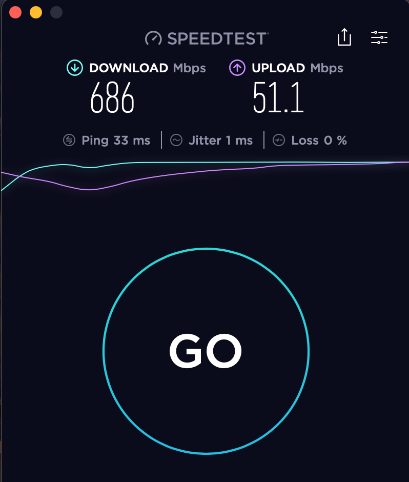

Here is my Mac Book Pro 2018 wireless results connected to RBS:

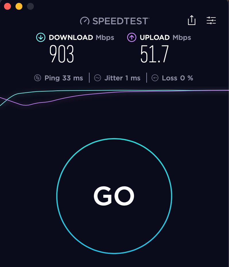

Here is my Mac Book Pro 2018 ethernet results connected to RBS:
