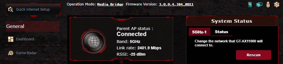

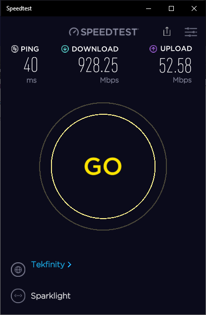

- FURRYe38May 11, 2020Guru - Experienced User
This is a test run with my ASUS GT-AX11000 wireless bridged to the RBR850. As you can see the connection rate is 2400Mpbs. The speed test maxes out since my ISP service is 1Gb and the LAN ports on the PC and the back of the ASUS is 1000Mpbs so we are seeing near or over 900Mpbs speeds on the down.
