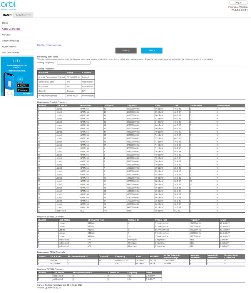

I have uploaded the connection status screen shot and the log screen shot... the log dont show much. it dont have anything prior to my last reboot this morning.

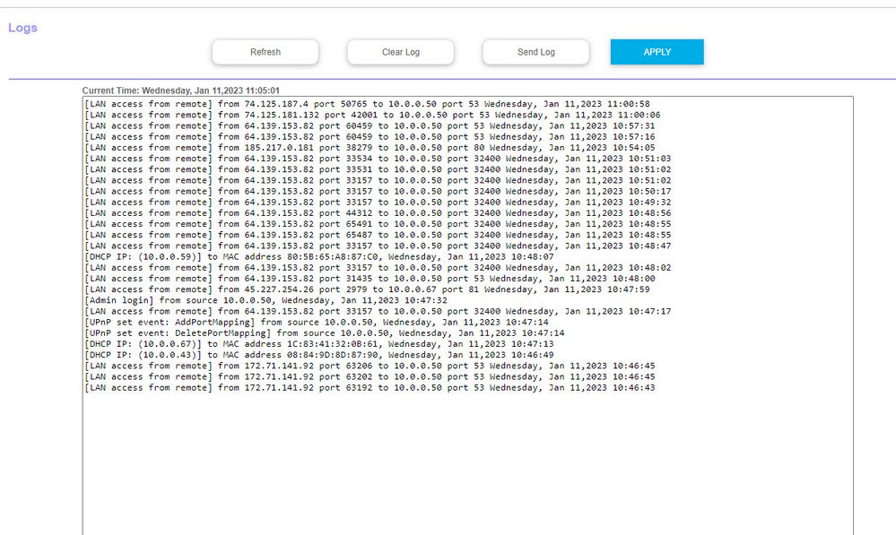

- a2literAspirant
Sorry got the wrong log file. I think this is what you wanted.
Power levels are a bit too high.
You have Criticals and Warnings in the event log that the ISP needs to review and resolve.
