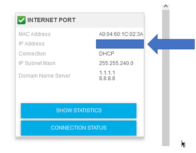

An easy (and quick) test is to look at the IP address reported on the Orbi web browser interface, Advanced Tab, in the box labeled "Internet"
When this IP is obviously not a "Private IP Address", then there is not a router between the Orbi and the Internet.
