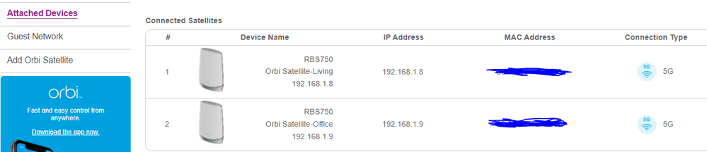

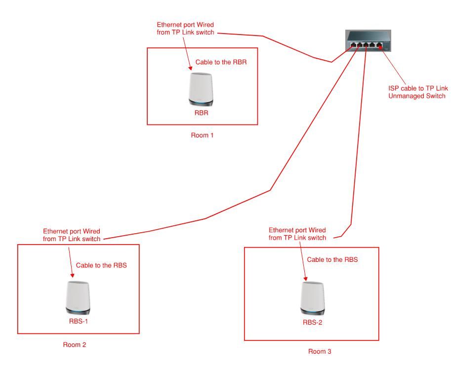

Hi guys, network noob here so appreciate your input. I got my RBK 753 last weekend and setup running now, some how the web UI always shows that my Satellite unit is under wireless connection, I have my Ethernet port at each room wired through a switch like below sketch, then pluged in the cable to all RBS units, did I miss anything? I checked my port with my old router, all functioning with internet signal and the firmware seems to be up to date on my RBR and RBSs. And my ISP is fiber so I got a cable into my internet junction box in the closet without a modem in the system, I pluged in this cable into my TP Link switch.

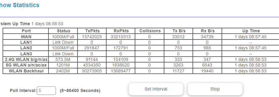

Interestingly to find out that under the Show Statistics window, I do see WLAN Backhaul with Tx and Rx data, does that mean the Backhaul is working?

Good suggestion, let me try that to exclude the possible issue with the switch (TP-Link TL-SG105). All my cables are Cat 7.
Orbi systems are designed to detect ethernet backhaul on the LAN ports, not the WAN port.
Since the router WAN port is connected to the switch and the LAN ports are not, then the router will not detect ethernet backhaul and will remain in WiFi backhaul mode (which appears to be working fine).
If there are two ethernet cables connecting the location of the switch and the location of the router, then one can be used for the WAN connection and one for a LAN connection. The ISP feed should not go though the switch to the WAN port.
