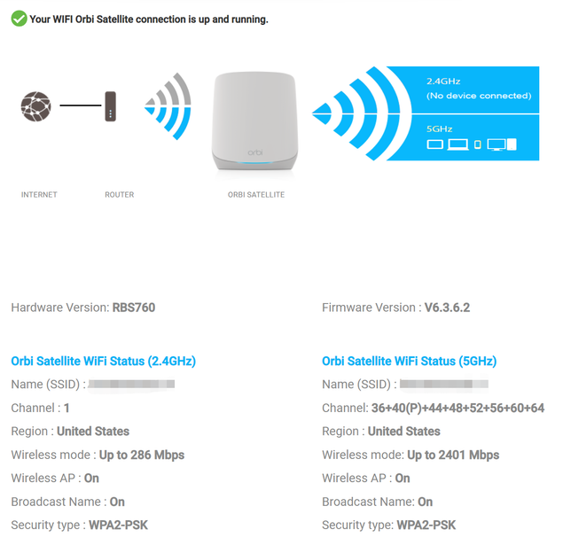

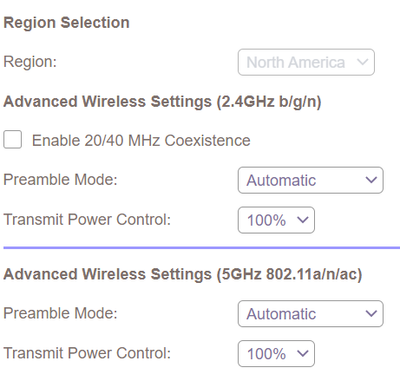

ORBI RBK 762 2.4G signal not operating at maximum speed
Hi everyone, The 2.4G WiFi of my Orbi RBK762 system is operating at 286.8 Mbps. I have already turned off 20/40 MHz Coexistence and I have also tried other channels. Preamble Mode is set at Autom...

Maybe a Web UI display code error here.
Log into the RBS web page and see what is displayed there?
Do you have any devices that can actually connect to the 2.4Gb radio to see what actual connection rate is seen?

Hi FURRY,
Do you mean this page? It still says 286M.
I do not have a smart device that can only connect to 2.4G but according to some of the devices located slightly further away from the router (not so far as the router sometimes assigns 5G to the device and sometimes 2.4G), I have never seen the link speed go above 200M on 2.4G.

- FURRYe38Jan 11, 2023Guru - Experienced User
Ok, that helps.
Please post the screen capture of the RBS web page now. Edit out the SSID name there before posting.
Is 40Mhz Co-existence only enabled Under Advanced Tab/Advanced Settings/Wireless Settings

Basic Tab/Wireless Settings.
- stuaidJan 11, 2023Tutor
Not exactly sure which web page you are referring to. This is the one I see if I type in the satellite's ip address into my browser.
Coexistence is NOT enabled as I thought this could half the maximum speed?
Yes this is the page.
Thank you.
You might go head and open a support ticket on this. Seems to be either a UI Display issue or a FW issue.
Spec sheet shows 600Mbps support on 2.4Ghz.
