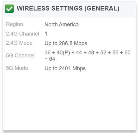

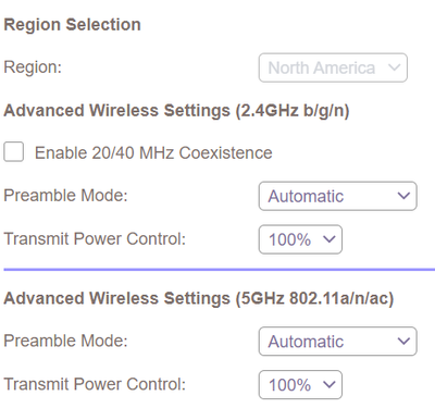

ORBI RBK 762 2.4G signal not operating at maximum speed
Hi everyone, The 2.4G WiFi of my Orbi RBK762 system is operating at 286.8 Mbps. I have already turned off 20/40 MHz Coexistence and I have also tried other channels. Preamble Mode is set at Autom...

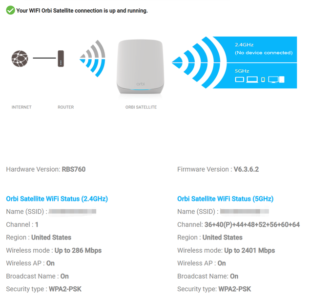

Do you mean this page? It still says 286M.
I do not have a smart device that can only connect to 2.4G but according to some of the devices located slightly further away from the router (not so far as the router sometimes assigns 5G to the device and sometimes 2.4G), I have never seen the link speed go above 200M on 2.4G.
I am using Chrome.
Jan 11, 2023Guru - Experienced User
Ok, that helps.
Please post the screen capture of the RBS web page now. Edit out the SSID name there before posting.
Is 40Mhz Co-existence only enabled Under Advanced Tab/Advanced Settings/Wireless Settings
- CrimpOnJan 11, 2023Guru - Experienced User
It has been so long ago that I honestly cannot remember what I set for the 2.4G channel. My memory is "auto" ( as in, "I don't have a preference, pick whatever you want."), but it clearly displays "8" on the WiFi setup page and this displays as 8(P)+4(S), which implies that this router is using 40MHz width for 2.4G.

- stuaidJan 11, 2023Tutor
Not exactly sure which web page you are referring to. This is the one I see if I type in the satellite's ip address into my browser.
Coexistence is NOT enabled as I thought this could half the maximum speed?
- FURRYe38Jan 11, 2023Guru - Experienced User
Yes this is the page.
Thank you.
You might go head and open a support ticket on this. Seems to be either a UI Display issue or a FW issue.
