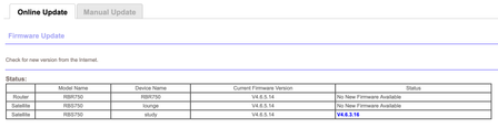

Orbi RBK753 has chucked my Airplay speakers off the network after firmware update
Orbi AX4200 WiFi 6 High-Performance Router (RBR750). (It doesn't fill me with confidence that this community forum doesn't have my Orbi model available in the selection field above. But heh ho.) ...
