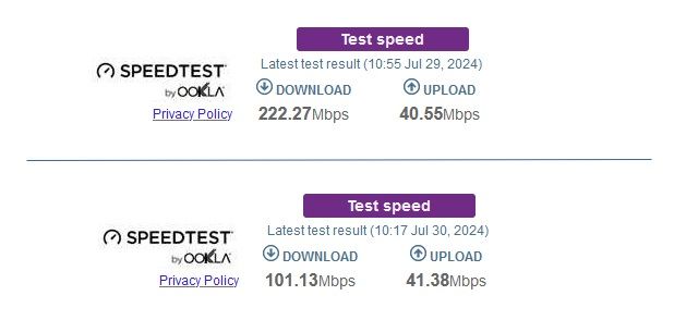

Hi All,
Again it happen the issue, I verified the debug section and nothing abnormal regarding the CPU and Memory usage
CPU Load: 16.01%
Memory Usage(Used/Total): 345 MB/874 MB
System Uptime: 0 days 21:36:20
Please see the speedtest captured on july 29 at 10:55 AM and one from today where the speed was reduced the half.
I already set the Orbi system as AP mode with the same result, it only works for some time and it reduces the speed after a period of time. Installing again the firmware could help with the issue?
Thanks for all the responses and help.
