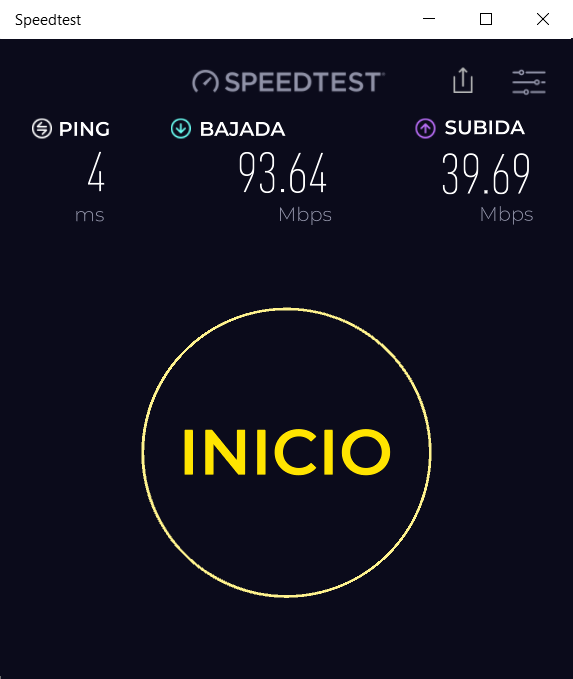

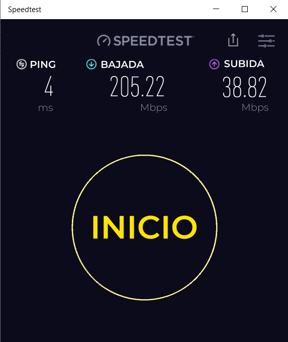

- javiersalasfJul 30, 2024Aspirant
Hello!
Thanks for your quick response, please see below, I have deactivated Wi-Fi on my laptop, I connected directly to the Orbi System and here is the speed test result from the installable app:
I did exactly the same test in the ISP modem, same etherne cable, same laptop with Wi-Fi deactivated in the speed test installable app.
