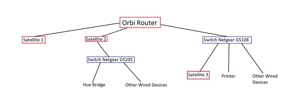

- akhilstyleNov 02, 2022Tutor
Updated the diagram as I had done it wrong earlier.
- FURRYe38Nov 02, 2022Guru - Experienced User
So if you remove the switches from in between the RBR and RBS, and connect the RBS directly to the back of the RBR, do they appear as wired RBS then?
So actually, even with the switches, everything shows as connected to the orbi via ethernet now. So that is not an issue. I am just having this issue where occasionally my iOS devices lose a connection and the icon spins for 2-5 mins. It's like they cannot get an IP address.
