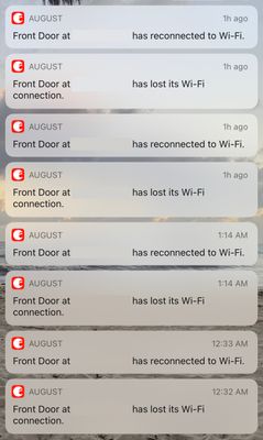

I recently installed the Orbi RBK753S mesh system with one wireless satellite and one backhauled satellite and while my coverage and speeds have increased over my previous setup, I keep getting notif...

I made the suggested changes last night before going to bed and it actually made matters significantly worse. Previously, this particular device may give me 1-2 notifications in the matter of 24 hours but just while I was asleep it lost connectivity 6 times. The behavior is the same with it reconnecting within about a minute. We have a WiFi baby monitor that also dropped connection 3 times overnight, which up until last night never had this issue. This August Front Door device is actually in a line of sight with one of the satellites so I know this is not an issue of signal.
