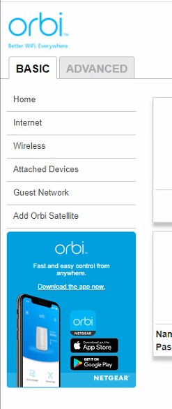

Quick question, do you see any Parental Controls on the RBRs web page, if so, can you attach a screen capture for us?
- randomtaskJul 13, 2021Tutor
I did see Smart Parental Controls mentioned in the firmware notes, but I'm not seeing anything referring to it when I log into the router when I traverse through the different menus. If you tell me specifically where it should be located I can tell you for certain if it's there or not.
- FURRYe38Jul 13, 2021Guru - Experienced User
Look under the Basic Tab for Parental Controls menu option?
Or Try under Advanced Tab/Security?
There maybe a Upgrade to Netgear SPC button seen here?
Please check Orbi app to see if anything appears there?
Nope, not seeing anything like in your screenshot or mention of parental controls under Advanced -> Security. The web interface also seems quite a bit slower than before, though I won't complain about that if performance/stability improves - so far my device did not disconnect/reconnect overnight.
https://i.imgur.com/L7B2Ymc.png
Ok, thanks for checking.
Will see if NG can provide some information on this.
