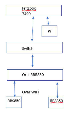

Hi, the ISP device is a Fritzbox 7490. The RBK is connected via LAN port to a switch -> Fritzbox. Connecting the RBK via WAN port was not working and causing a flickering WAN connection. The RASPI is connected via the mentioned switch.

So this is what it looks like?
- schadanMar 30, 2023Guide
Hi, yes, the diagram fits quite well. Yes, I know about the EOL of isc-dhcp-server. The switch is a tp-link tl-1008 unmanged desktop switch.
As described connecting the RBK850 via WAN doesn‘t work unfortunately. What would be the reason why connecting via WAN port when the RBK is in ap mode would make sense? Thanks.
