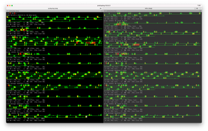

Turning off the RBS was a good idea. I just unplugged it. Unfortunately, preliminary results would still indicate I'm getting these intermittent droppings. Here's the latest from my test location: (left ping is base station 10.0.0.1, right ping is Google): Link if image is broken:
I'll now try and plug the RBS back in and turn the RBR power down to 50% and update here when I have results. That being said, if your theory is interference problems between the router and base station, it's concerning that the version with no RBS still shows the intermittent drops.

Also your picture up on dropbox is no longer there:
"This item was deleted
You might be able to find it in your deleted files. If it's not there, try asking the person who shared it with you."Has a factory reset and setup from scratch after the FW was updated on the RBR and RBS?- emorikawaApr 12, 2021Aspirant
Yes, the Modem WiFi is fully disabled. I'll try the Modem in router mode and the Orbi in AP mode next and let you know how that goes.
Dropbox link fixed. This one should work. I also edited the reply above.
