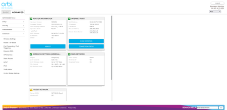

I have attached a photo with all these details, but I'm not sure why it does not show up.

See if anything that I configured on mine will help you out.
