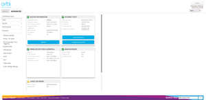

I have attached a photo with all these details, but I'm not sure why it does not show up.
The firmware version is V4.6.3.16_2.0.51.
There is no specific information printed on my modem, but it is just a regular modem without wireless capabilities.
The throttling does not happen when I directly connect my PC to the modem, so I'm pretty sure Orbi is the root cause.
The distance between the router and the satellite is exactly about 30 feets, with a door blocking in between.
I did perform a detailed Wi-Fi scan so that I could select a channel that no one is using, but that did not help.
Also disabled Armor and Parental Control for sure, CTS had no effect as well, no collisions are shown in the logs.
