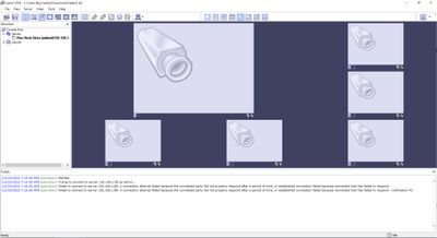

Orbi RBK853 (AX6000) I cannot connect to my Luxriot security camera server
Hello,
     I replaced a Google WIFI 3 puck mesh system with the Orbi and can no longer connect to my security camera's from my HTPC.  It's a pretty simple (was) conneciton.  In the Client you just use the IP address, Login ID and Password.   I can ping the ip of the server and it responds properly from my HTPC.   For whatever reason the Server will no longer allow the connection.
The camera server is an I7 windows 10 PC
* wired lan connection
*LuxRiot VMS Server installed, and configured to allow connections
* static IP set
*reservation set with IP during troubleshooting
*I opened ports 8080 and 60554 per LuxRiot troubleshooting (didn't have this set on the Google)

      Well nothing on the camera system...   So I had issues with other stuff that were resolved, some easy, some not so... because my primary on the google was 192.168.86.1 vs 192.168.1.1.   I have a lot of fixed IP's because of Control4 etc. and the only thing that would never work besides this issue is my iAqualink pool controller.  It would NEVER connect wifi and I ended up having to install a point to point wireless bridge to get that to work.
      So I just had to changed the IP config to reset the fixed IP of the PC.
