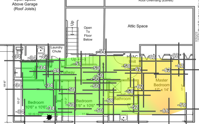

All I know of is "marketing fluff" (another term for outrageous exaggerations that all vendors put out, including Netgear) I did a Heat Map on my two story house and found that the upstairs (where the ISP modem and Orbi router are) got pretty decent coverage:
But measuring the signal from that upstairs router in the downstairs area was "not great".
No wonder people were carping "why is the WiFi so BAD in the Living Room, Dining Room, and when I sit on the porch???"
With a one story building, it depends on how many walls/obstacles there are.
The 23m wing will probably do just fine with a satellite in the corner and one about in the middle of the wing.
The 35m wing is a bit long.
