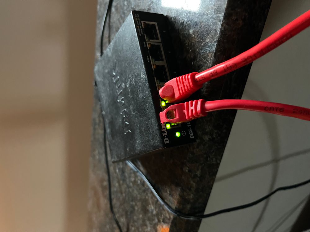

Here is my 960 connected to a simple D-LInk DGS-105 Gb switch connected to a CAX30 modem:
Port 1 is the cable coming from the 960. Port 2 is the cable going to the CAX30 modem.
Power OFF the RBR and switch then connect the WAN port to your switch. Do not use a cross over cable. Don't connect the StarLink adapter to the switch just yet. Power ON the RBR and switch. The Switch should see the connection and both LEDs should be GREEN for the port the 960 is connected too on the 108 switch.
