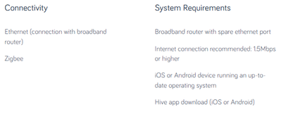

The technical specs on the Hive Radiator valve say that it connects using Zigbee:
This is from: https://www.hivehome.com/shop/smart-heating/hive-radiator-valve
Orbi WiFi routers do not support Zigbee. If the smartphone app is to control the valve using WiFi, there must be a Zigbee hub connected to the WiFi system to act as a bridge.
Is the Hive Hub already connected to the router with an Ethernet cable?
https://www.hivehome.com/shop/connectivity/hive-hub
