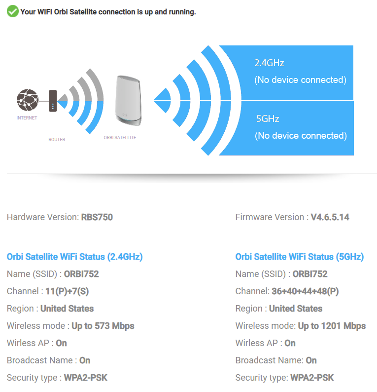

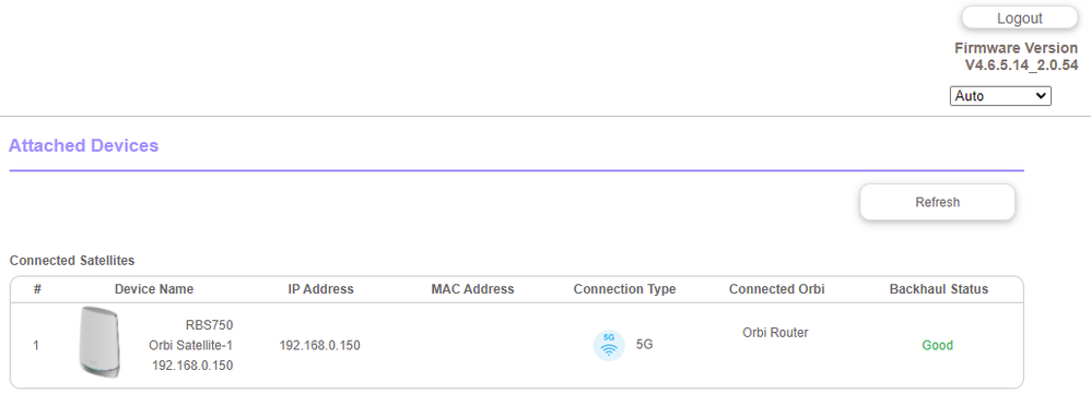

Ok you got me curious about this. So I configured my RBR750 for AP Mode, installed a different router and got the other router and modem working. I disconnected the RBR from the modem after I rebooted the modem and left it disconnecte. Afer the other router and modem were ready. I took my wired PC and configured the RBR for AP mode using static IP address and appled the change. Once I saw the RBR reboot and front LED turn on WHITE, I plugged in the RBRs WAN port to the other routers LAN port. RBR came to ready and front LED turned OFF. I looked at the RBS750 which was wirelessly connected and it was blinking white. I checked the RBRs web page and saw it was Disconnected. I waited a few minutes more. I then saw the RBS appear on the RBRs web page however status was out of sync and IP address was default 1.250 for the RBS. I was able to access the RBS web page by looking at the other routers web page and found the RBS got a new IP address, 0.150. I checked the RBS and front LED was BLUE. I was able to access the RBS web page however the status page didn't load for some reason. I checked the RBS front LED and it had gone back to blinking WHITE. I when back and checked the RBRS web page and it reported disconnected. So I figured, lets power OFF the RBS for some seconds then back ON.
Let it come to ready and the RBS appeared on the other routers web page. Finally the RBR reported the RBS connected and using correct IP address:
I was able to access the RBS web page and this time the status loaded and reported correct information there. Check the front LED and it was BLUE.
Looking back at the RBRs web page, the status changed to GOOD.
Checking the RBS again just now the front LED is now OFF.
