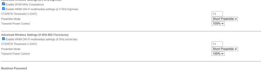

https://community.netgear.com/t5/Orbi-App/NETGEAR-Mobile-Applications-and-Apple-Devices-FAQ/td-p/2220016/jump-to/first-unread-messageSet 20/40Mhz Coexistence to 40Mhz only. Set CTS to 64. Set Short preamble instead of Long preamble modes. Save settings and reboot the router and satellite(s). Under Advanced Tab/Advanced Settings/Wireless Settings

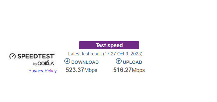

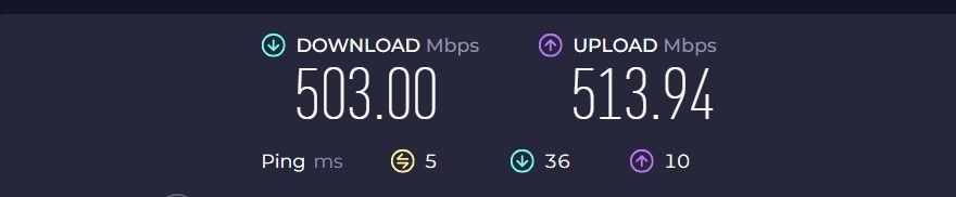

Speedtest in pictures. There is no signal problem in house, i have one router and 2 satellites and both are connected via cable, youutbe.com problem is from 2 weeks and before that everything was perfect every stream website and app is working normal, only problem is youtube.com, House is 7000 sq ft ,
