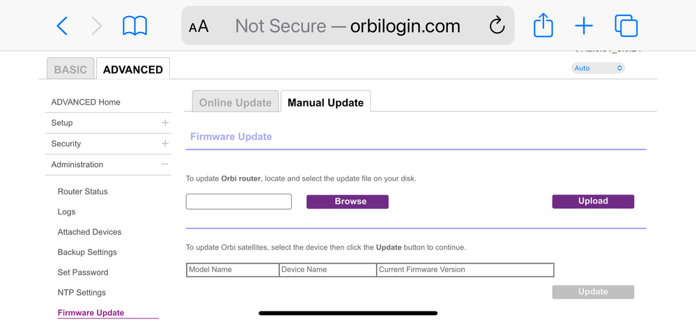

- CrimpOnJun 15, 2024Guru - Experienced User
After downloading firmware and unpacking the *.chk file from the *.zip file:
- Connect to the web interface
- Navigate to the Advanced Tab (and wait until it loads fully)
- Open the Administration menu
- Open the Firmware Update menu
- Click on the Advanced Tab
- "above the line" is a section to manually update the router
- "below the line" there should be a row for each satellite.
Click on one of the satellites and proceed to follow the directions to browse to the location of the *.chk file for satellites and upload it.
The issue is that sometimes when satellites are on different firmware than the router, they do not appear in the manual update tab.
- vdotmatrixJun 15, 2024Guide
- Select the check box next to your satellite's model name. THIS DOESN'T APPEAR.
Click on one of the satellites and proceed to follow the directions to browse to the location of the *.chk file for satellites and upload it.I AM ON MY WINDOWS BOX DOWNSTAIRS AND THIS DOESN'T APPEAR HERE EITHER.

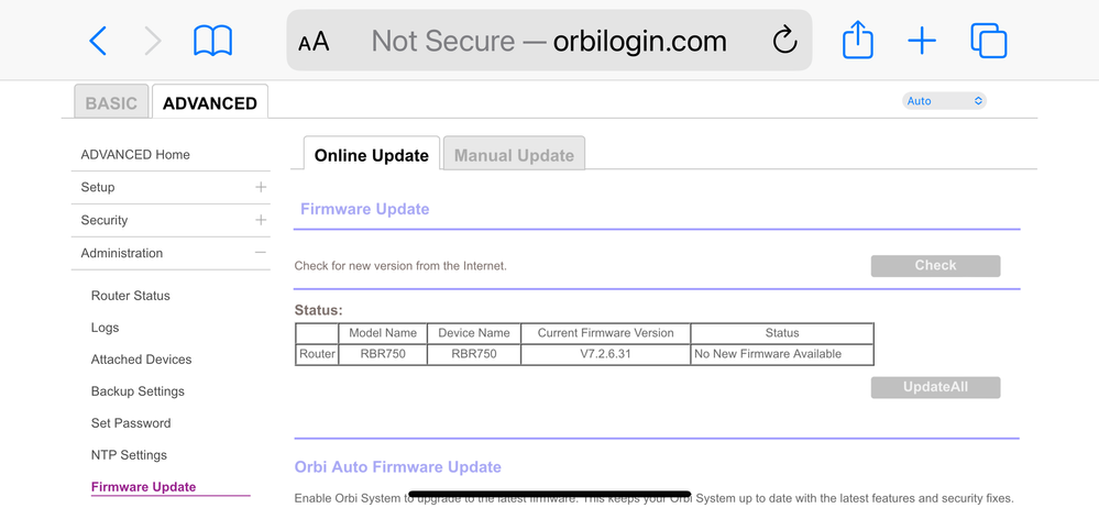

This is all I see. The satellites do appear as an option
...Satellites do NOT appear as an option.

”If you can get in using admin and password, and check to see FW version here. If it hasn't been updated, then you can updated here.” I CAN GET IN, but FW VERSIONS NOT VISIBLE AND THERE IS NO WAY TO AFFECT THE SATELLITE FW. I DON’T SEE A WAY TO “update here”.
“Or ethernet connect the RBS to the back of the RBR and use the given IP address for each RBS to log into the RBS web pages and update the RBS directly to there web page using the RBS files you have on your PC“ ALL THIS DID WAS SAY IT WAS WIRED TO THE RBR.
Using the IP ADDRESSES on a MAC or a PC THERE STILL NO WAY TO SELECT A GIVEN SATELLITE FOR FIRMWARE UPDATE.!!!!!!!!!!!!!!!!!!!!!!!!!!!

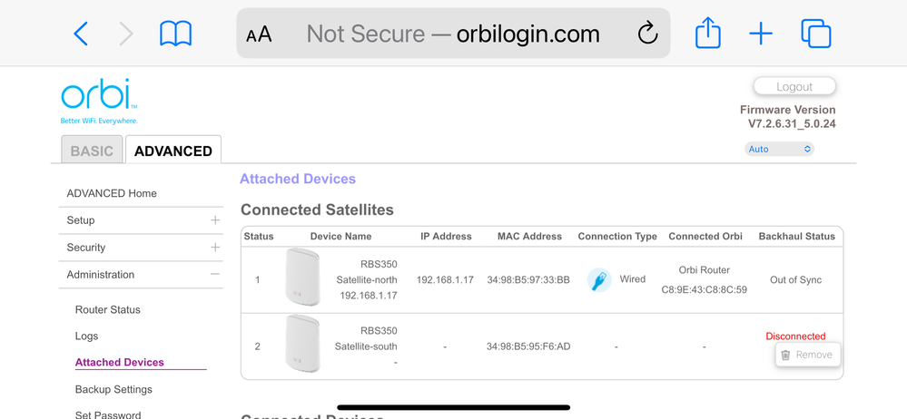

- vdotmatrixJun 16, 2024Guide
Well after almost 24 hours working with volunteers here, I now have ZERO satellites in my network with NOWAY to upgrade or revert to a previous FW.
I have no idea why it is necessary to do this.
i have factory reset the rbr and the rbs a number of times, connected each individually with ethernet cable. NO JOY
THE last thing i could do is simply upload the v4 into the RBR against instructions to first update the RBS then the RBR, but right now all that is working is the RBR.
This is the second expensive NETGEAR system that we have had that has met an unfortunate and aggravating end-after the 8000 nighthawk thing.
where do I go from here? If any of you can please look through each screen shot and possibly see a button or check box that I missed to update the FW on the RBR or RBS, I will be a monkey’s uncle-whatever that means.
