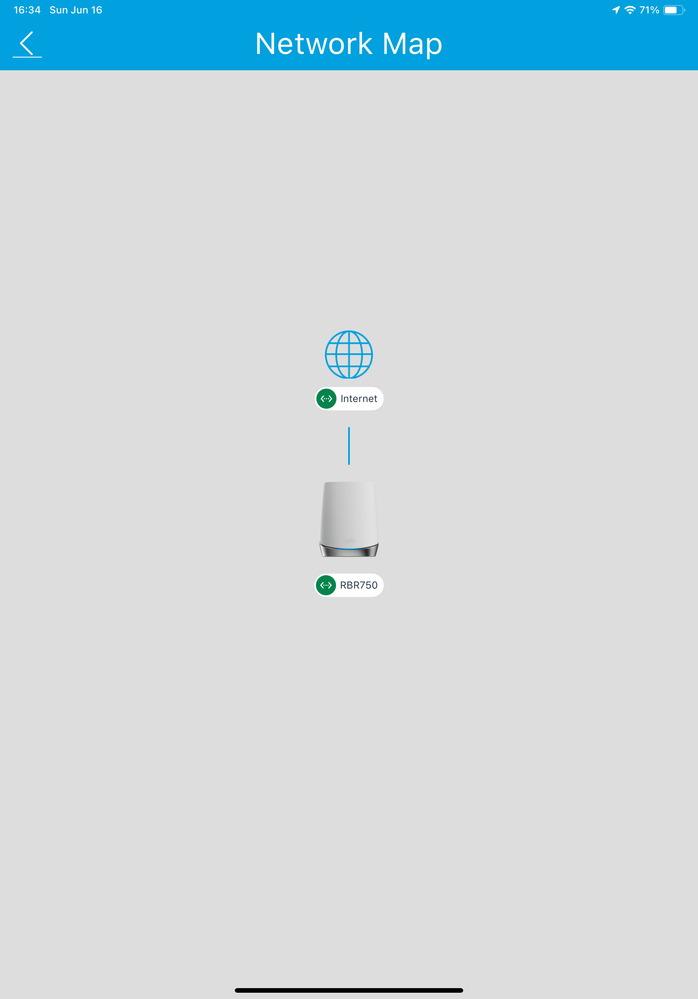

Well after almost 24 hours working with volunteers here, I now have ZERO satellites in my network with NOWAY to upgrade or revert to a previous FW.
I have no idea why it is necessary to do this.
i have factory reset the rbr and the rbs a number of times, connected each individually with ethernet cable. NO JOY
THE last thing i could do is simply upload the v4 into the RBR against instructions to first update the RBS then the RBR, but right now all that is working is the RBR.
This is the second expensive NETGEAR system that we have had that has met an unfortunate and aggravating end-after the 8000 nighthawk thing.
where do I go from here? If any of you can please look through each screen shot and possibly see a button or check box that I missed to update the FW on the RBR or RBS, I will be a monkey’s uncle-whatever that means.

I this case you have to load v4 FW back ON to the RBR since the RBS are probably already on V4 FW. All you need to do is to downgrade the RBR back to V4 FW. As mentioned in my 3rd post to you in this thread.

Since v.21 would not be applied to the RBS350s, these are probably still on v4 FW so there is no need to dowgrade or do any FW anything with the RBS350s. Only need to downgrade the RBR back to v4 as mentioned already.
- CrimpOnJun 16, 2024Guru - Experienced User
I agree. When an RBR750 router is connected to only RBS750 satellites, then all of the units can be updated to the latest firmware (satellites first). When any RBS350 satellites are connected to the RBR750, they will function only if the RBR750 remains on firmware v4.6.14.3
