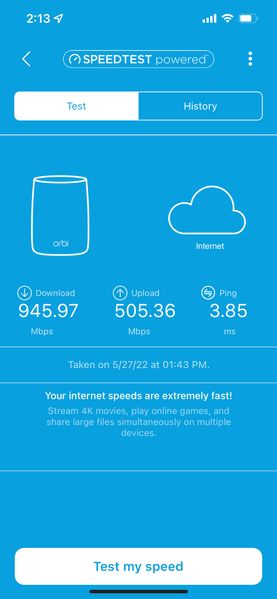

Orbi RBR750 Slow WiFi Speed
I was finally able to get fiber at my house I have a 1Gig set up and currently have Orbi RBR750 for the router and two RBS350 for satellites. My modem speed is getting to the router at 945. showing i...

the RBR750 has a a front haul and a backhaul. the front haul is a 600mbps 2.4ghz connection with a 1.2gig 5ghz connection. the backhaul is a 2400mbps backhaul (not user accessible). those are just link speeds, not actual throughput speeds. (2.4ghz throughput is horrible).
With your system, they paired it with a set of dual band satellites. Not triband so they don't connect to the dedicated backhaul. They've got the 600mbps 2.4ghz, 1.2gig 5ghz. But again thats link speed, not actual throughput. Not having a dedicated backhaul is going to make the satellites slower than using the rbs750 satellites with the dedicated backhaul.
Basically you have a triband mesh system that only has dual band satellites. so they satellites aren't going to have the same performance as the router.
