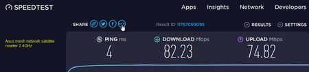

Yes both are on at the same time. I guess I could unplug the Asus in case it's interfering with the Orbi. It doesn't appear the Orbi is interfering with the Asus. Looks like the pictures showed up in this post.

This is a speed test with the Asus routers turned off.
Orbi with Asus turned offThe Orbi app on my phone shows my WiFi signal strength -35 just between very good and amazing. The inter net speed test is coming in at 200 Mbps up and down which is exacty what I'm paying for with my ISP.
- TAC57Jul 20, 2021Aspirant
Since I can't see the screenshots this is the data.
Asus: ping 4 msec, DL 83Mbps, UL 75Mbps
Orbi:
With Asus routers on: ping 6, DL 18Mbps, UL 23Mbps
With Asus routers off: ping 6, DL 32Mbps, UP 43Mbps.
