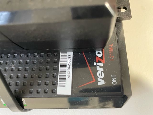

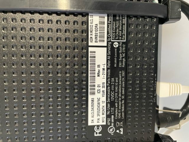

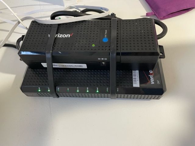

When my Orbi was first set up it was to a Neatgear Nighthawk modem GHZ_EX6400v2
We switched ISP to Verizon Fios and it is now connected to a verizon modem, see photos attached.
The issue of a device randomly dropping the wifi was persistant with both modem connections.
Thanks again for everyones help and support.
