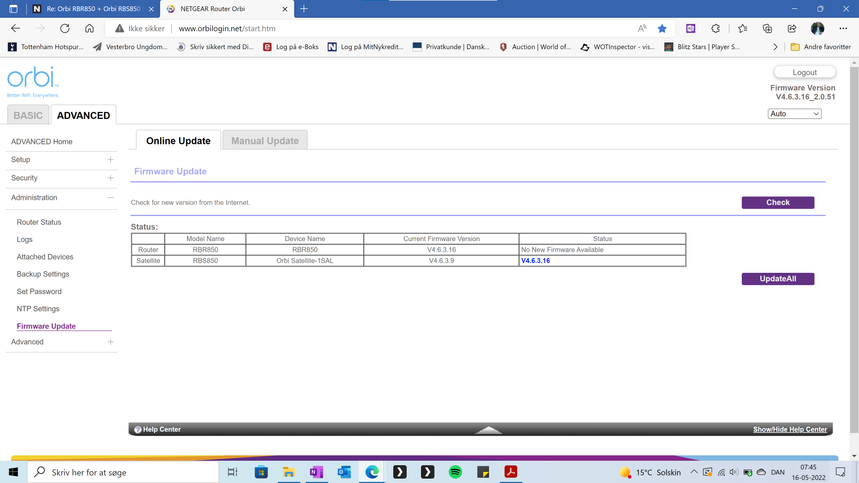

- ksog070274May 15, 2022Aspirant
Hi againg
Firmware is overridden automatically to the below version for the router at least. I will try and stick with this version and make it work as good as it possibly can, but as I recall it and in my notes, issues began around this version upgrade. I do not expect to much. I kind of have the feeling of being stuck here, but apperantly I got to accept this and cross my fingers for an upgrade in the future that works. I can't see what I possibly can do to get this fixed sadly enough.
I will post here when I am back up and running with final comments!
