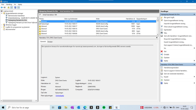

After a couple of stable days, the issue is back as I expected. See below Windows Log for errors. It is just a short interruption, but anyway anoying when streaming or gaming. Just not good enough. I hope a solution will emerge, rather sooner than later. I will leave this thread open and unclarified for now.

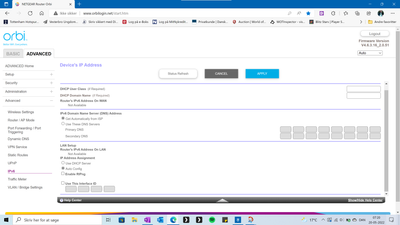

Is IPv6 enabled on the RBR? If not, what happens if you enable it and just Auto settings there?
- ksog070274May 19, 2022Aspirant
I have now activated IPv6 with auto settings, see below. I will wait and see.

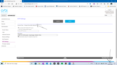

Furthermore I have noticed the following - an attempt to auto update router even though I recall you said it should be disabled and another issue but not as important is the NTP time server not setting the correct time. I have attached screenshots below.
An auto-update firmware failed, maybe the cause of the interruption yesterday?
NTP setting.
I will monitor with IPv6 enabled and get back to you.
