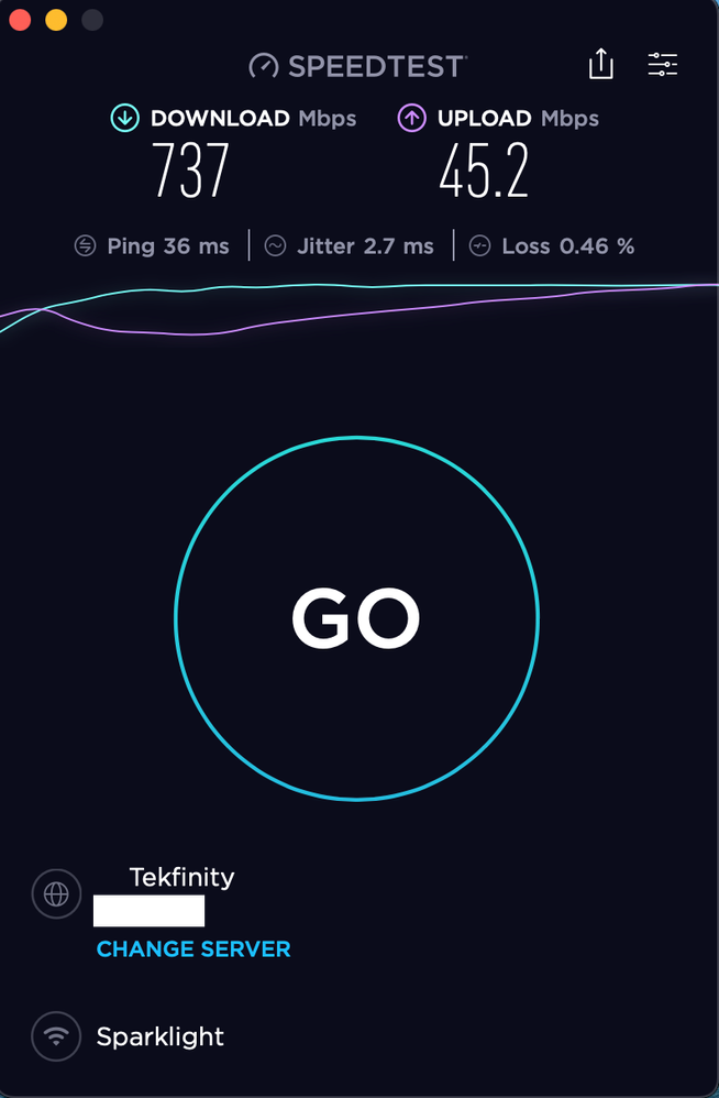

What is the distance between the router and 📡 satellite(s)? 30 feet or more is recommended in between RBR and RBS📡 to begin with depending upon building materials when wirelessly connected.Here my Mac Book Pro speeds at 1300Mpbs connection rate: OSX 12.0.1
My 8 series current settings and configuration:
