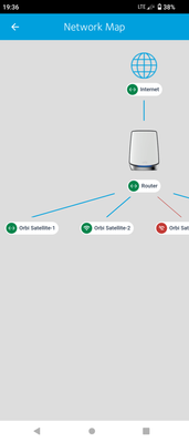

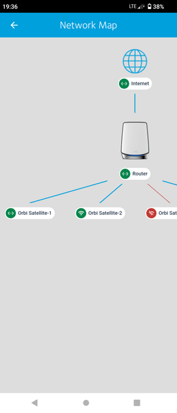

Orbi RBR853 - What do the symbols mean in the Network Map?
Hi again, is trying to fix an issue I realise I don't understand the small graphics on the Network map. Possible anyone can explain those please e.g the green left & right arrows, the red one I g...

Hello moonwatcher64,
The red lines that you are seeing in the photo indicate that the connected satellites are not currently connected to your Orbi router.

Hi Kevin and thanks for the reply and answer
Yes I assumed red meant off-line but the other graphics were confusing. Again the wifi one seems obvious but the left and right arrows confused me. By deduction it has to 'wired' connections.
But the confusion turns out to be deeper in fact as ALL our Orbi's are 'wired'. In the open case we have (and being supported well) it turns out that even though we can catagorically show and prove that all the Orbi's are wired, that the app / Orbilogin can report that they are 'wireless' .... and more confusing again, this can change and move between Orbi's.
Sounds unlikely I know but is the case. It's being worked through but appears FW independent.
Just for update.
- ekhalilSep 07, 2022Master
moonwatcher64 wrote:........ Again the wifi one seems obvious but the left and right arrows confused me. By deduction it has to 'wired' connections.
Yes, the right-left arrows symbol means the satellite is wired to the router (wired backhaul).
If you have a wired satellite that shows it's wirelessly connected, then you should check the backhaul wiring and the used switches, that would mean that there is an issue with the wired connectivity. When satellite thinks the wired backhaul has issues it will try to connect wirelessly if it finds a broadcasted backhaul SSID from any other node to connect to.

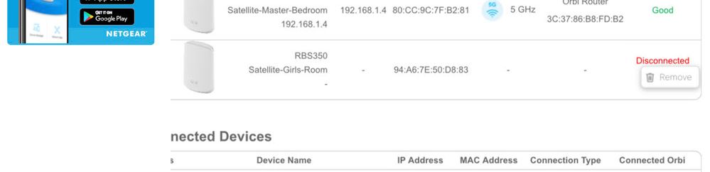

Sometime ago, I had an issue with my wired backhaul with a specific firmware, that turned out to be that the satellites don't like to be paired both on wired connections and wirelessly at the same time (double-paired).
I suggest to test to remove all wireless pairing between the satellites and the router and only keep the pairing with wired connections. Please do the following:
- Disconnect all cables from the Orbi's.
- Switch off the satellites
- Use the web interface and click on "Attached Devices".
- When you see the sateliites "Disconnected" and with a button called "Remove" beside, click that button to remove the pairing from the satellite. See picture below:
- Now that all satellites are un-paired, connect the cables and press the sysc buttons on all the satellites and on the router.
- Wait until the satellites' LED's turn blue to confirm successful pairing
