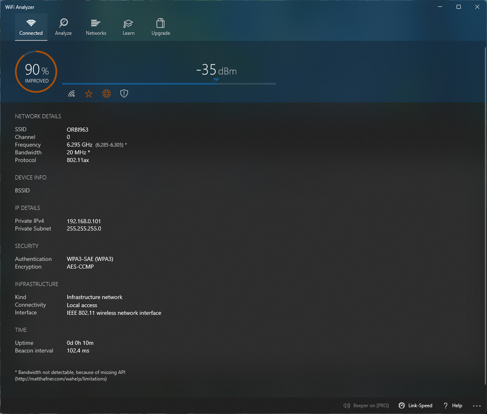

- FURRYe38Jun 26, 2022Guru - Experienced User
Been told that the separate 6Ghz SSID is to let users ensure that there 6Ghz devices connect specifically to the 6Ghz radio only.
There is a 6Ghz signal being broadcast along with the 2.4 and 5Ghz signal on the main WLAN.If you disable the separate 6Ghz signal on the RBR and connect a 6Ghz device to the main WLAN, it will connect to the 6Ghz signal while that separate 6Ghz radio is disabled.
This is my PC using Intel AX210 adapter connected to the 960s main WLAN with the separate 6Ghz radio disabled:
