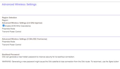

- FURRYe38Jun 15, 2024Guru - Experienced User
Ok, try this, Under Advanced Tab/Advanced Settings/Wireless Settings there is a Generate button here. This is for the backhaul password. Lets press this and apply the change, then soon after, with the RBS in same room as RBR, press the reset button in back for 15 seconds then release. Don't use ethernet on the RBS for this. When the front LED seems to begin to pulsate WHITE or blink WHITE, say about a minute after you release the reset button, use the RBRs web page to ADD Satellite method, see if this can get the RBS to connect and sync. The web page will let you know if it failed or was successful.

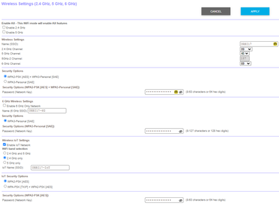

- dsolsonJun 15, 2024Aspirant
Here are some web router network setting pics if that helps.
I turned AX off for 2.4 and 5 ghz when I got the router. I asume that doesnt matter?
I use the IoT set hard at 2.4 ghz for amny devices in house with only one router as 5ghz doesnt hold well when farther away form router
