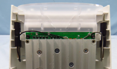

    FURRYe38 is correct that the radiation pattern will be similar to a typical "vertical dipole".  Since I could not find the FCC submission for the RBR350, here is an internal picture of an earlier Orbi router:
    Notice the two combination 2.4G/5G antennas mounted approximately vertically.  This will result in a roughly donut shaped radiation pattern, with the lowest radiation directly above and directly below the unit.  If you open the RBR350 or RBS350 case, my bet is that the antennas will look very similar.
