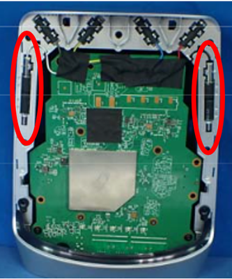

      I agree with FURRYe38 .  As the fcc internal photos show, the user facing antennas are mounted vertically on each side of the case:
      (The antennas mounted at angles are the 5G 'backhaul' antennas)
      Thus, the system will function identically with both orientations.  (Turned on one side or lying on the front or back would probably create a strange situation.)
      Being high enough to clear furniture and obvious obstacles is often recommended.  At the top of a "high ceiling" might not be a great idea.  I also agree that the product is obviously engineered with the idea of convection cooling from the bottom.
