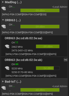

WiFi Analyzer products typically display every WiFi access point they detect, including your neighbors. Here is a screen shot from my phone:
Notice that SSID ORBI63 appears two times:
Channel 11 is the 2.4G channel and Channel 44 is the 5G channel. If I had clicked on the triangles next to MadDog and Bad-IoT, they would have expanded to show both channels on those SSIDs as well. These happen to be from an Orbi RBR750 I am experimenting with.
My guess is that if you check the WiFi strength at the door locations, it will appear to be very strong.
