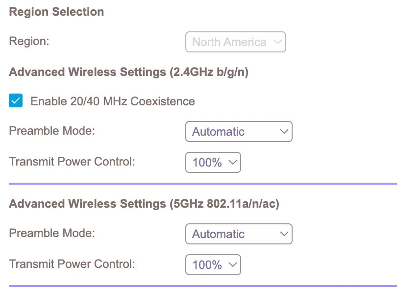

OK, just checking. Be sure that you don't update the RBR to any RBK750 series FW. Though it can update it, there is NO FW updates on v7 for the RBS that come with the RBR750 in the 760 series kit. So keep with the 760 series FW on both RBR and RBS for your 760 series kit.
I don't know if or when NG will put something out for the 760 series kit.
Lets try this, try turning down the power output of the RBRs wifi radios from 100% to 25% and see if this changes anything. Under Advanced Tab/Advanced Settings/Wireless Settings

- katiejim1214Nov 28, 2023Guide
Hi! Doing this now - do I adjust both the 2.4 and 5 or just one or the other?
