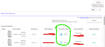

Orbi RS750 ethernet overhaul
Hi! I have a mesh network made of one router and two satellites and have been having issues with the ethernet overhaul and overall network stability (probably because the satellites keep jumping ...

When I disconnect the "living room" Orbi from power, the network goes back to being fully stable. Once I connect it, even the other wired connections have instability, so, the problem is definitely in that satellite.

I'd check the wiring to ensure the switch isn't connected to the gateway and the orbi. I"ve seen that to many times.
the switch has to come after the orbi. Nothing else should be connected to the gateway but the orbi
