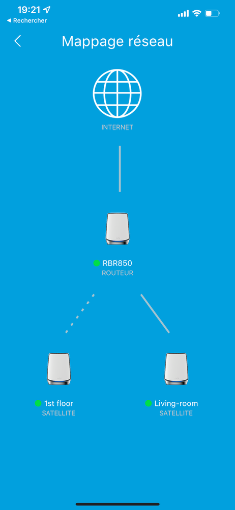

I have a satelliteat the first floor synced by wifi, and another satelitte wiredly connected at the living-room.
I have 2 questiosn here:

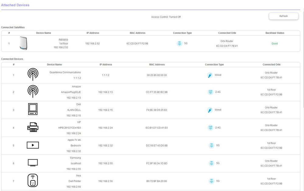

  1. Is it okay to connect a satellite to ethernet, because even though it got an IP address and I can see it through the orbi app (not through the web interface though), no devices are connecting to it, they all go to connect to the first floor satellite even though some devices are 2 feet from the satellite.
    Orbi app, I can see Living roomLiving room does not appear

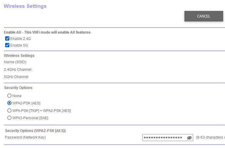

  2. Is the AX wifi compatible with WPA2 passwords? I got a message that it will go faster with WPA3.
    The is WPA3 compatible with 2.4 Ghz devices? I still have smart bulbs, amazon devices, and Label printer that connect only to 2.4 Ghz.

    1. Is it okay to connect a satellite to ethernet, because even though it got an IP address and I can see it through the orbi app (not through the web interface though), no devices are connecting to it, they all go to connect to the first floor satellite even though some devices are 2 feet from the satellite. Yes. Might try turning down the power output of the RBR to help steer some devices to the RBS. It's up to the devices to pick and choose where they connect too. Under Advanced Tab/Advanced Settings/Wireless Settings
    2. Is the AX wifi compatible with WPA2 passwords? Yes. I got a message that it will go faster with WPA3. Where did you get this information? WPA doesn't really effect speeds.
      The is WPA3 compatible with 2.4 Ghz devices? I still have smart bulbs, amazon devices, and Label printer that connect only to 2.4 Ghz. You have to check with the devices mfr about WPA3 support. NOt all devices may support WPA3.
