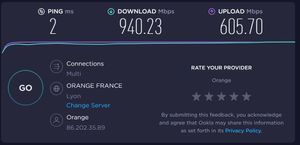

Hi everybody i have a RBR750 with 6 RBS the house is big so i needed a wide coverage. The RBR is connected to optic fiber (900mgb download 600mgb upload). The RBR is then connected to a giga lan s...

One other thing to check for the connection link is to direct connect a satellite to the router and hardwire a pc/laptop into the satellite to check its speed. And try a different cable between them. I've seen a sketchy cable or one that had a poor crimp on one end cause it to only link at 10/100mbps speeds and not gigabit.

i will try the speed test as you recommended and let u know the outcome

i will then try to fix the issue of the slow speed and let u know what are the results
