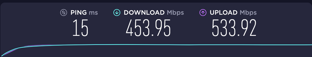

- Got good speeds in the beginning, see attached, but now again same thing, fluctuatiing speed and I am right next to it and only have a MacBook Pro (2018) connected and iPhone 11 Pro.

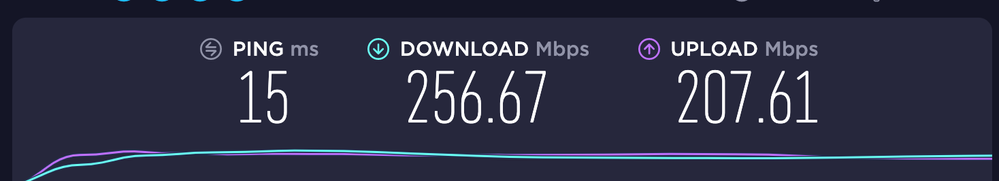

Done. But check out the spees on iPhone 11 pro that is capable of getting the WiFi 6 speeds.
- Dd852Sep 13, 2020LuminaryTo be honest i think the 11 pro while capable doesn’t prioritize it. I can get 600+ if and only if I switch off the phones WiFi and switch it on again in the vicinity of the router. If I roam into the room I will get 300-400 but not the blazing fast. I’m not fussed because honestly i have absolutely no need for that speed, perhaps you do. I’m just happy that my Mac in my office (near a satellite and away from the router) is now consistently 400 up/down. Obviously not 1 gig but it is fine for my needs and stability and consistency will always be more important for me.
