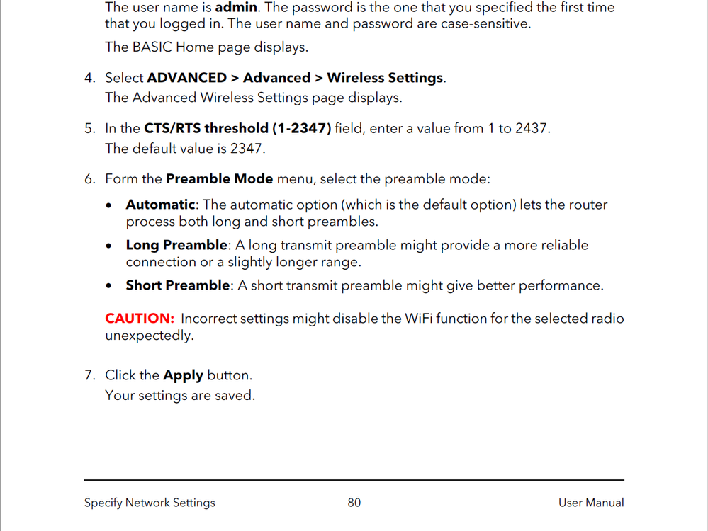

FURRYe38 wrote:What CTS values are you using currently on the 9 series RBR? I'm using default 64 on mine.
I noticed in the AXE user manual that it says the default CTS/RTS threshold is 2347. Page 80:
- FURRYe38Nov 19, 2021Guru - Experienced User
PDF info is problably template from older PDFs. Needs to be updated.:smileyembarrassed:
