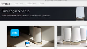

orbilogin.com "admin" pop-up not there
My internet was getting a little slow and lagged at times. So, I went to at AT&T's website and used the "Restart Gateway" option. I have the Motorola BGW210-700. No problem! Internet is running fine!...

- I am trying to access orbilogin.com
- I am using Safari
- I don't know what firmware I have. How would I check that?
- Seeing that a double NAT was ill-advised, I thought I set it up as an access point (several months ago) but I'll do the troubleshooting tips and see if I can fix it. Hindsight being 20/20, I wish I'd tried logging into orbilogin.com prior to "Restarting the Gateway"

No luck on Firefox. It went to the same netgear page referenced in my original post.
