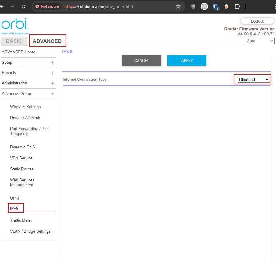

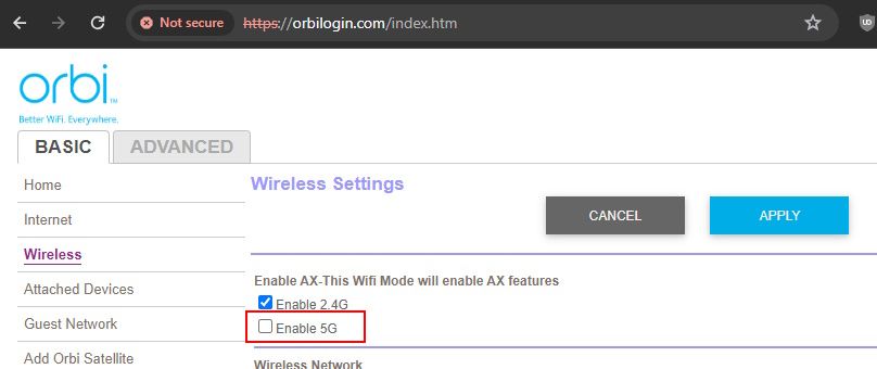

- Matto4Jan 04, 2024Aspirant
Well for anyone else having similar issues these changes seem to have fixed my issues for now.
A) MS Teams not refreshing on Android 14 / Outlooking not showing new messages.
B) Google Nest Hub 2 not working / something went wrong / there was a Glitch over and over... Linked to IPv6 from google searching.
Turning off IPv6 at this level seems to have worked in combination with disabling AX mode on 5Ghz WiFi. Neither seem to fix the problem when just done by themselves...
