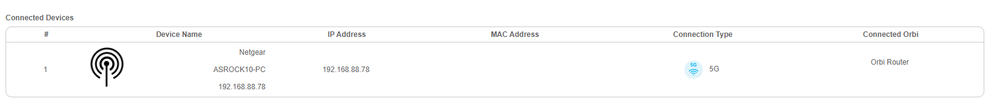

      Ok got me curious. I dragged out my R7800 and it does connect to my RBR850 in AP mode:
      The 88.78 address is the static IP address I configured on the R7800.

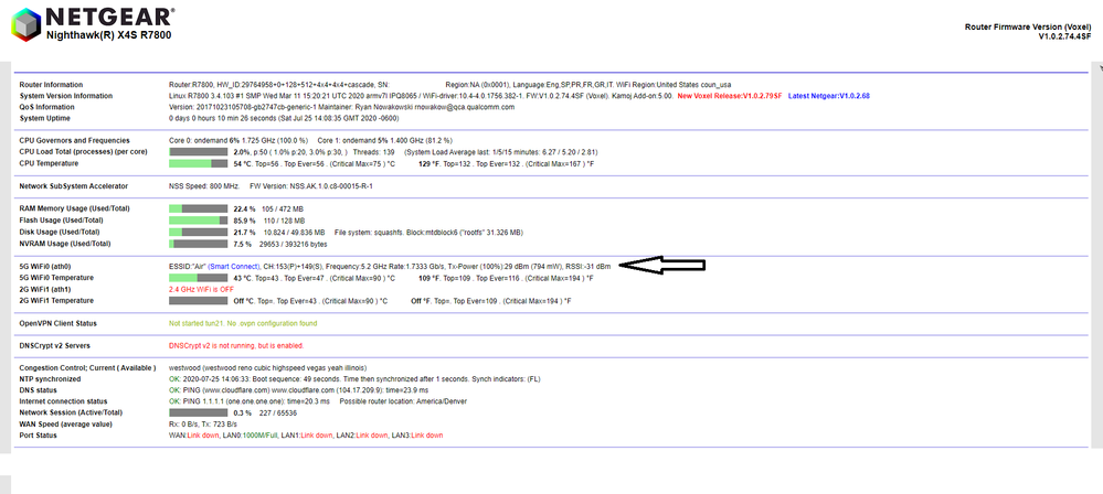

      This is non stock R7800 FW (Voxel's) which has this additional information which is not seen on stock FW:
      Wireless speeds are low however I don't expect alot from the R7800. Also the router that the RBR850 in AP mode is connected to doesn't support 1Gb WAN services which at this time I tested with.
      So the R7800 may see a bit more speed on 5Ghz however not sure. Lots of factors in speed testing wifi. I may come back to this when I go to put my RBR850 online as my main host router to check wireless speed performances.
      So at least we know the R7800 does wirelessly bridge connect to the RBR850.
