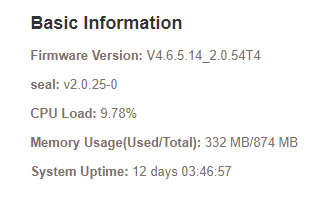

Loaded today over on top of previous un-released v4.6.5.14 which ran with no problems for 12 days:

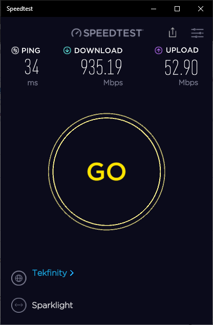

Wireless speed test thru the system using a PC connected to the ASUS GT-AX11000 in wireless bridge mode:

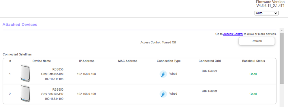

One thing I notice is that the Atteched Devices list is sorted by IP address from Low to High numbers. This is nice.
