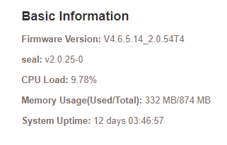

RBK 8 Series Only - Unofficial v4.6.6.11 Firmware Experiences
So since NG is giving out some unofficial FW to those who have called in to NG support and users have posted links to this version of FW, I figured I'd try it myself.
